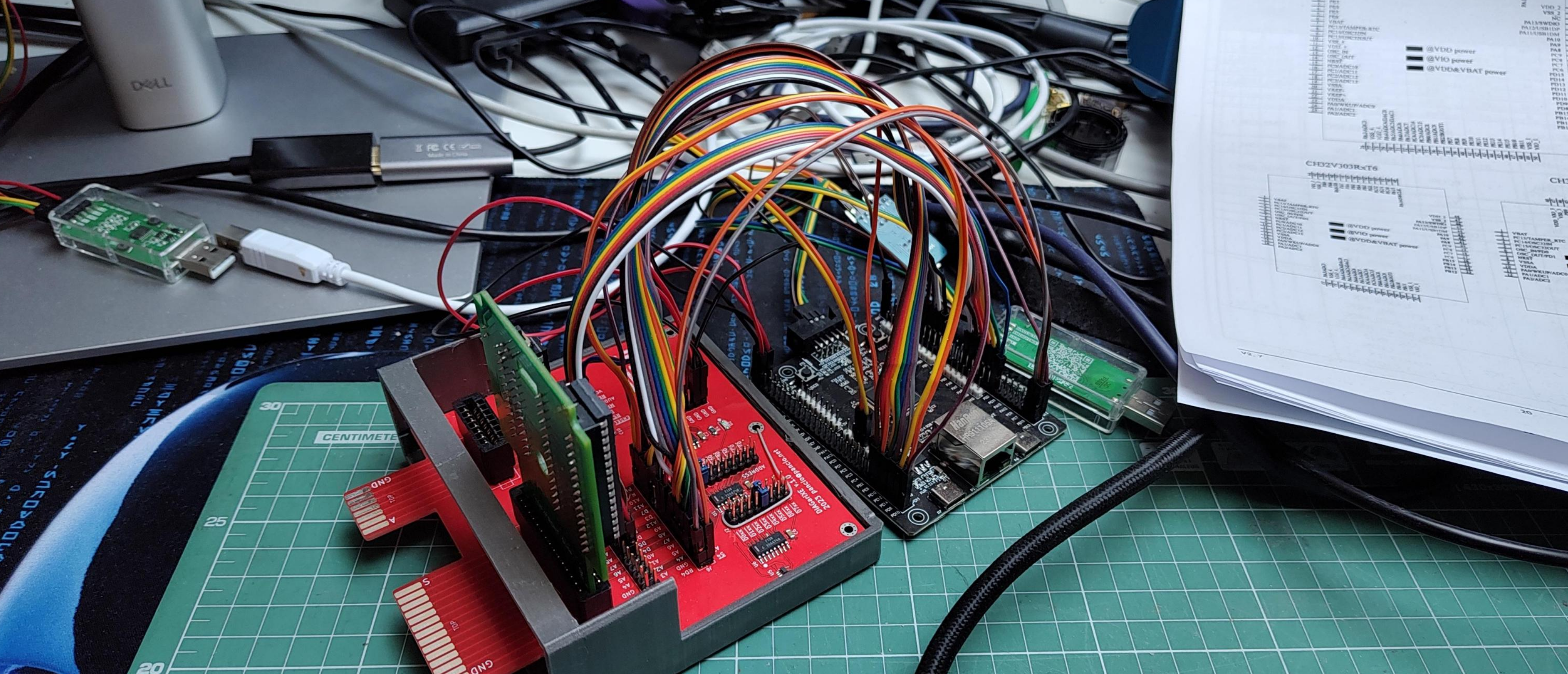

I am currently working on a project that will allow for quick CART recording. Reading works at the level of 512KB in 5 seconds! I can't provide implementation details yet, but my runtime looks like this:
So it's possible that The Cart! will be written and read very quickly. Unfortunately JAC! doesn't respond to me and I don't know the cart's memory structure to be able to implement it...
1) developer view: more cables, please 😂
2) user view: not the standard config. of an A8 😂
Last weekend I attended the "Midwinter Meeting" . There SvOlli has a new SUB (AVG) card (https://abbuc.de/forum/viewtopic.php?t=1835) with all 3 connectors (PBI/SIO/Aux) and I have to say that for somebody who has an unodified machine, this is surely the best cart/extension by far. It looks like a cartridge, but effectively is it a PBI device that comes with modification-free 1 MB memory expansion, stereo POKEY and 100% ATR/CAS/... emulation via SIO and easy firmware updates.
Regarding The!Cart: You are not forgotten Pancio, but I first had to get a real Linux machine to setup a proper C development that can target the Risc V for the board I've received. I firgured a seprate Thinkpad soley for Linux would be the best option. And now I have it setup so I compile (ARM, but not yet Risc V). Esp. SvOlli helped me at the meeting to setup the toolchain for hist own 6502 project (https://xayax.net/sorbus/) that uses RP2024. And now extending this for Risk V should be feasible.
Regarding The!Cart: You are not forgotten Pancio,...
Ehlo! just provide mi the data :-)
BR, pancio
